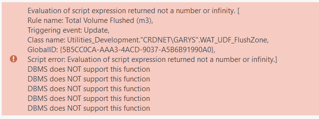

I am trying to create an attribute rule that calculates the total volume of the pipe within a polygon. The trouble I am having is that there is multiple sizes of pipes within the polygon.
So far I tried this expression and the arcade expression is valid, however when I adjust the polygon an error happens due to the attribute rule.
var WatPipe = Filter(FeaturesetByName($datastore, 'WAT_Pipes', ['*']), "status = 'in service' and Owner='City'")
//calculate radius off of pipesizes that are in millimeters and converted to meters
Var piperadius=['pipesize']/2/1000
var Diameter=Pi*piperadius*piperadius
var relevantpipe=contains($feature,WatPipe)
var volume=diameter*length(relevantpipe)
return sum(volume)
Here is the error I receive
Please help me out!
