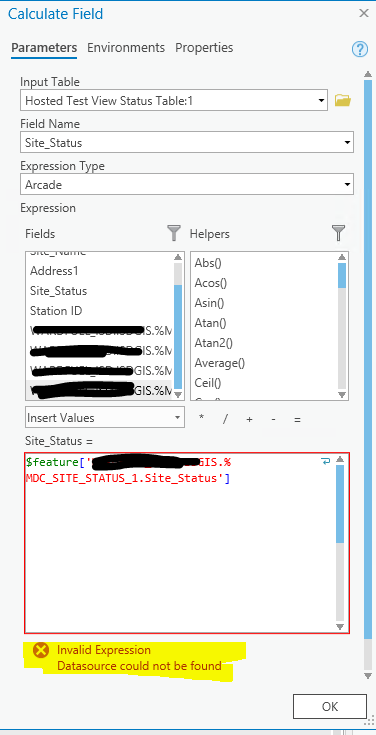

I am using ArcGIS Pro 2.9 and I have done the following in Model Builder:
Connected to a SQL view
Connected to a Hosted table
Performed an Add Join to join both tables (the other join creates a permanent join which I dont need)
So far this works and the join appears.
Then, I use the Calculate Field tool to calculate one field on the hosted from the SQL view.
I get the error that I cannot use SQL unless its a feature service. Fine, use Python or Arcade.
But when I open those, the reference to the view fields looks like this
Then, when I try to enter the expression, I get an error
I cant get passed this.
Why would it ask for the datasource if the data source is already there and the data is already joined?
Is it the percent sign? I tried removing it but it doesnt work.
I cant find any documentation on this.
Thanks everyone.
BigLouC
Apparently, if I ignore the error message and continue, still works. It says invalid but still allows me to use the reference.
