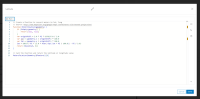

@JeffShaner any updates on this? It looks like this topic was tagged as an ArcGIS Pro question but I'd like to have USNG/MGRS added to a field upon entry in Field Maps and Smart Forms, similar to the way it works in QuickCapture as a device variable OR via an Arcade calculation (whatever works). I figured out how to apply lat/long in decimal degrees...
...but USNG is a requirement as per FEMAD092-5_dated.pdf (usngi.org)
So I really need to figure this out ASAP as we roll out Field Maps for additional field data collection / editing.
