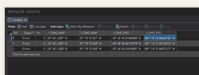

I've recently started using Pro for some processes I've done hundreds of times.  After investigating some unexplained changes in the hundredth decimal place of some DMS coordinates I decided to compare Map vs. Pro calculate geometry results for some coordinates.  Same shapefile, same geographic coordinate system NAD 83 (1986, the original one), no projection.  The difference bewteen Map and Pro for the first coordinate pair longitude is 55.831" versus 55.843", similar results for the other coordinates as below with MAP being the ArcMap results and Pro being the Pro results.
Am I missing something or is this a bug with Pro's calculate geometry?

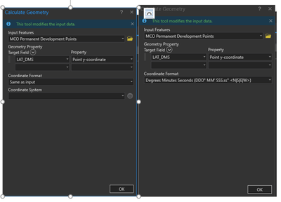

Did you actually select/specify the output coordinate system?  It says that the input coordinate system will be used by default, but then there is this confusing bit which says if not specified, WGS84 datum will be used.  You might be wise to give a check and make sure that the input coordinate system appeared in the dialog name and wasn't blank

Weirdly Pro didn't give me the option to pick a coordinate system; (Map does, it picked up vanilla NAD 83 from this experiment's shapefile) once I changed the coordinate formant from same as input to DMS, the choose coordinate system options on Pro goes away, as below:
I did both the calculate geometries in a new blank map in an effort to make sure there was only coordinate system to work with.  I have Pro options set to use the spatial reference of the first operational layer so it should just pick up the NAD 83 that this shapefile has:
