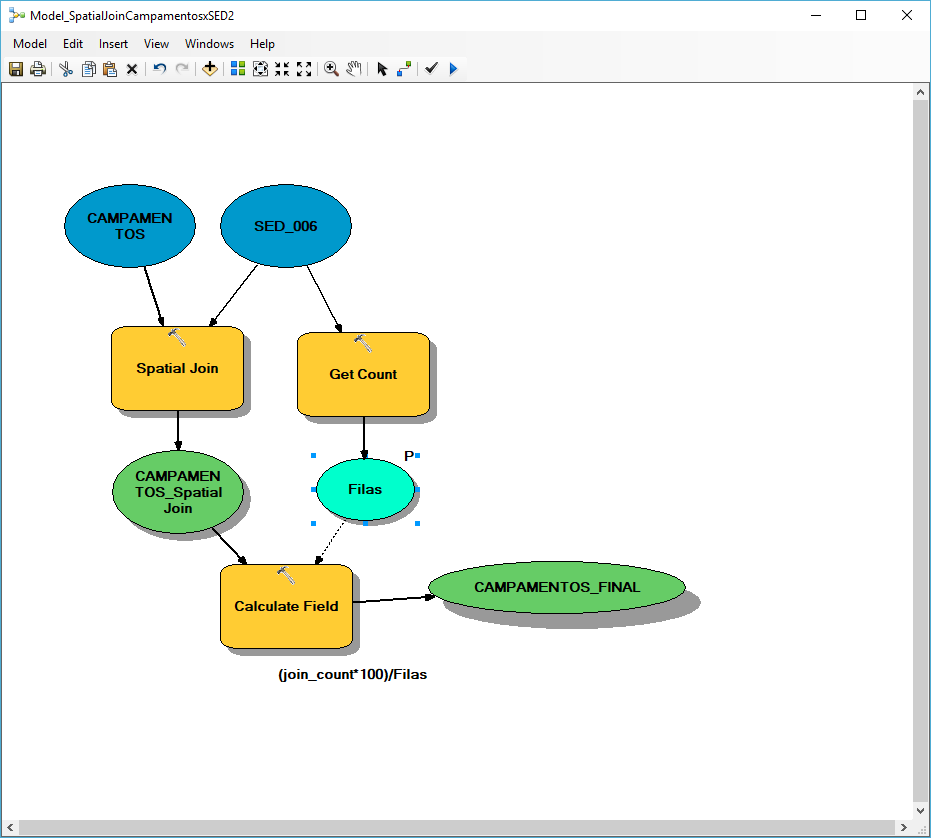

Im pretty new on using arcmap and specially using the modelViewer.
Im trying to do the following:
I have 2 layers, point and polygon, that i used a spatial join to know how many points are intersected in the polygon layer.
After i generate the result in a join_count field, i want to add in the percentaje field, the % related to the total of points that i have.
My model is the following.: campamentos is my polygon layer and sed_006 is my point layer.
After executing the model, the percentaje field is still 0.
My formula for calculate field is ([Join_Count]*100)/Filas.
What am i doing wrong?
Thanks for all the help provided!

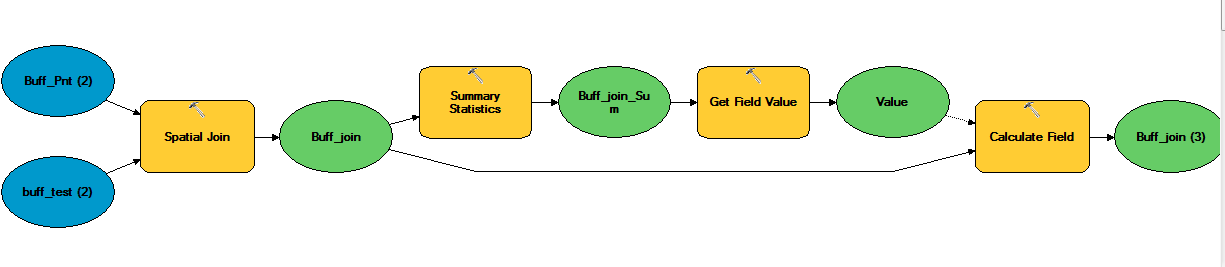

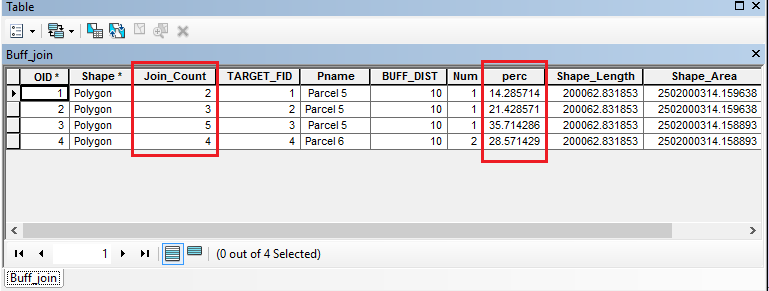

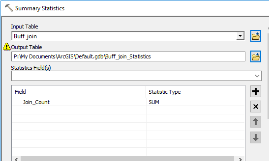

I used the following workflow
Summary Statistics: SUM
Get Field Value:
The expression in my Calculate Field Tool looks like this
([Join_Count]*100)/%Value%
Result:
Think Location

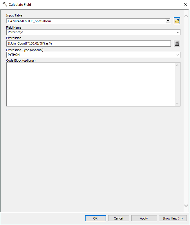

just a guess but that looks like vb syntax.  and assuming it is a field, you might want to try python syntax
!join_count!*100.0/filas
Now if it isn't the python vs vb thing, then you should always promote one of the variables to ensure that the math is done as floating point math that is why I put 100.0 instead of 100, since the latter is an integer
EvelynHernandez
You mean this? (It didnt work tho)
Get Field Value:
Result:
Think Location

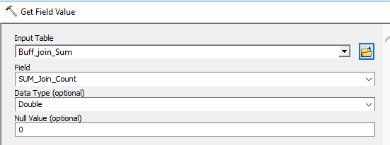

JayantaPoddar
MVP Alum
You can see Get Field Value tool here.
Think Location
