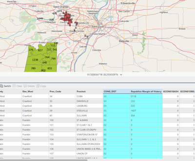

MarkAnderson6
Thanks for the reply. Here is a screen print of my attribute table and a segment of my map showing the disparities. The fields you reference GCONXXX01 and GCONXXX03 (my typo in first post) are as follow: GCONXXX01, GCONXXX03 are the identifiers for General Election, candidate's truncated last name and party and 01 and 03 refers to Congressional district. I used the xyz as a redaction. The field Republican Margin of Victory is the one I created and the field I wrote the expression for. The data type for the field is double, numeric, no decimal places.

AyanPalit
@MarkAnderson6 Thanks,  based on the additional info, there seems to be an issue with the data logic.
The calculation expression is simple, wherein it's looking at the 2 fields per district feature and calculating the difference. It is certainly possible to get results for both the district extents. This is working for your first district but not for the second.
Are you using the same set of fields for the second district? If so, check if the fields have proper values and there is no filter/selection excluding the calculation.
