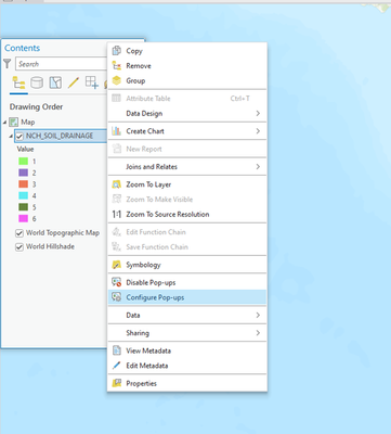

I have raster datasets (soil drainage, soil permeability and , soil rooting depth) with the Pixel Type unsigned char, unsigned char and double precision respectively. How can I build the attribute table of these in ArcGIS Pro? All layers have a single band.

I did it. But I don't see the attribute table.

I can't tell what type of raster is from the image, but there is something preventing the table being built.
eg. This tool will not run if the pixel type is floating point or double precision.
copy the raster to a *.tif in a local folder.
if the raster type is integer, build the raster attribute table on it.
