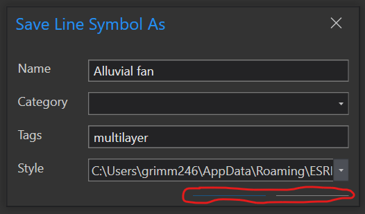

I recently upgraded to ArcGIS Pro 3.2, and when trying to save symbols, colors, etc. to styles, the OK and Cancel buttons in the "Save Item As" window that pops up are barely visible:
The buttons still work, but there is no way to resize the window. Has anyone else experienced this?

Solved my own problem: when I went to go look at some style files in C:\users\username\AppData\Roaming\ESRI, there were a couple of folders called "ArcGISPro_StrongName_xyz...". Not knowing what those were, I deleted them, and when I reopened Pro, it had reset my application theme from dark back to light. I then set it back to dark, closed and reopened Pro, and when I went to save symbols to a style file, the OK and Cancel buttons appeared!
