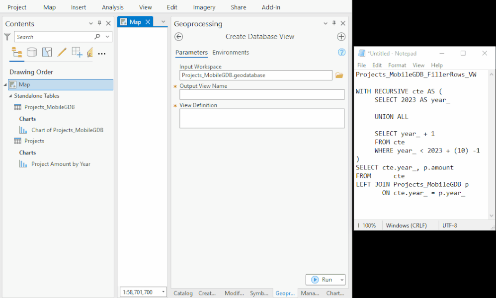

I'm creating a view in a ArcGIS Pro 3.0.3 mobile geodatabase.
I've entered the view name. Now, I'll paste SQL into the View Definition (using CTRL+V, since right-click >> paste is greyed out).
Problem: When I run the GP tool, the name that I entered previously gets cleared.
That's not the desired behavior.
WITH RECURSIVE cte AS (
SELECT 2023 AS year_
UNION ALL
SELECT year_ + 1
FROM cte
WHERE year_ < 2023 + (10) -1
SELECT row_number() over (ORDER BY cte.year_, amount) as OBJECTID, cte.year_, p.amount
FROM cte
LEFT JOIN Projects_MobileGDB p
ON cte.year_ = p.year_
Could that issue be fixed?

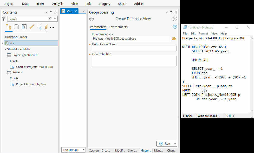

It may be related to your indentations.  Try having your blank lines within the common table expression indented the same amount as the other lines.
Bud
Legendary Contributor
@JoshuaBixby
Good idea. I took an extreme approach by removing all indentations and line breaks:
WITH RECURSIVE cte AS (SELECT 2023 AS year_ UNION ALL SELECT year_ + 1 FROM cte WHERE year_ < 2023 + (10) -1) SELECT row_number() over (ORDER BY cte.year_, amount) as OBJECTID, cte.year_, p.amount FROM cte LEFT JOIN Projects_MobileGDB p ON cte.year_ = p.year_
Unfortunately, I'm still seeing the same issue. The name gets cleared when I paste in the SQL.
Bud
Esri Canada Case 03257552  Create view ... View name gets cleared when run
BUG-000155888 - In the Create Database View geoprocessing tool, the Output View Name parameter is cleared when the first click after entering the Output View Name occurs outside of the tool interface.
