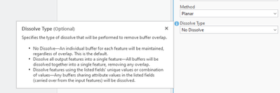

Would you be able to send a screenshot of what you see in terms of the options and different check boxes you used? In 3.5, this could be different, but there is a setting for "No Dissolve" which should prevent it from being multipart:

Thanks for your response. The options and descriptions I see are the same as those in your screenshot.
I used one of the "Dissolve" options rather than "No Dissolve" as two of my land parcels are close together and I wanted a single buffer around them (i.e. no overlap). I've created buffers this way for years without problem, yesterday was the first time this happened after updating to version 3.6.0.
This morning I tried creating buffers around my land parcels using the three dissolve type options. Using "No Dissolve" created singlepart features but there was overlap between buffers, while both of the "Dissolve" options created the unwanted multipart buffer features.

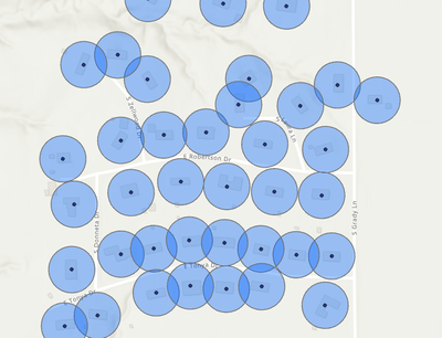

First, create the buffer, as you can see there's intersecting polygons on these addresses:

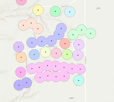

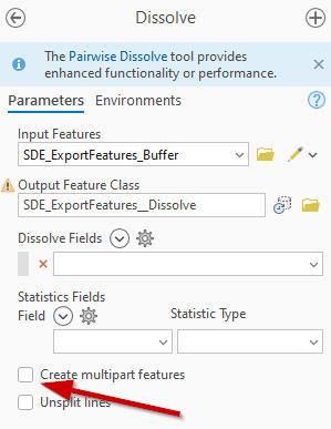

Next, Use the dissolve tool to bring these all together, these are my settings:
Ensure you have the "Create multipart features" unchecked, your result should look something like this here:
So in this workflow here, you'd be able to create your buffer, along with dissolving the features in a way they're not multipart, these are all independent polygons except the ones that overlap here!
