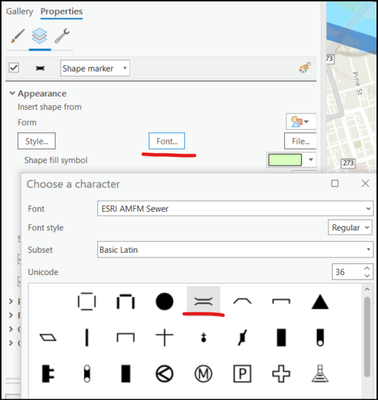

You can create a bridge symbol by inserting a shape from the ESRI AMFM Sewer font or build one using the symbol to the right of the bridge symbol in the graphic.
bcgeogirl1
This is perfect, I have been looking for one without the box around it. thank you
