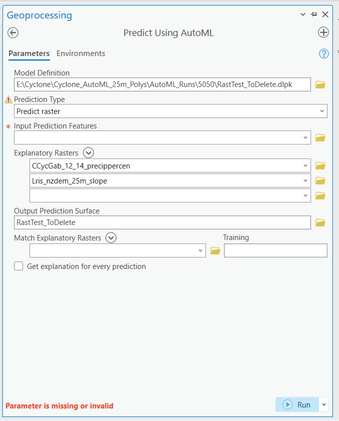

I am using the Train AutoML and Predict AutoML tools in 3.1. I can successfully train my model using raster data as input, however when using the predict to raster tool it keeps asking for a point file (i.e. the red asterisk never disappears) and so the tool won't run. "Parameter missing error".
If I train the tool on a point dataset (i.e. extract values from the rasters first), and then also run predict on a point dataset (again with values extracted from the rasters) everything works fine.
Do you have any suggestions why predict to raster won't run?

My goal is to predict 28 different ecozone types (acidic cove, northern hardwood, etc) using plot data (n=5,000ish) and about 44 different environmental variables as explanatory variables. Our study is area is large (~7 million acres) and the spatial resolution is fairly fine (5m). I'm running Pro 3.4.0 and can successfully train model on a smaller clipped out area (~700k acres) using only 6 explanatory variables for a smaller subset of ecozone types (n=18, where the total number is greater than 1% of total plots).  However, the Predict Using AutoML errors out consistently after 2.5 hours and provides a generic Error 260204.
We are testing this modeling approach to see if it works better than our current approach and I have 10 more days to figure it out as I'm using a trial license to gain tool access.
Any help would be appreciated. These seems like a good application of the tools but maybe I'm missing something simple.
Attached images show result of trying to predict just 4 of the ecozones based on a model trained for those 4 ecozones only.

Thank you for the quick responses Karthik - answers below:
  1. Training took 50 seconds. screen shots of the input and output attached.
  2. Basic model training on a single ecozone fails in 3 seconds for all model types (warning 260151).
  3. Display name is the same as actual raster name.
  4. Zip attached with the 4 ecozone types (corresponds to all screen shots I've shared) and the successfully trained model (.dlpk)
attempting to predict 'ecozone' based on the other six variables in the file.
I could clip rasters to a smaller area, but I still wouldn't be able to attach those without exceeding upload limit.
