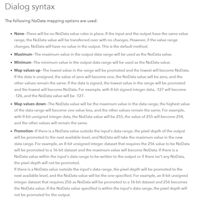

Also which Resampling No Data method out of the available five is better for DEMs?

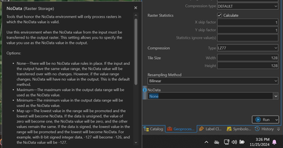

Now what method should I use for No Data Values because i can't leave them empty since i have to later use the `Smooth High Resolution DEM` tool in ArcHydro and this tool requires the DEM to not have empty No Data values

If you have nodata in your area, it is there for a reason, so I would stick with None to keep it so.  This doesn't fill in values, it only assigns a value to use for nodata.
I am not inclined to fill in nodata areas under any circumstances (eg via focal statistics or regiongroup and nibble depending on the data type) unless they are only a couple of cells in size

Ed_
by MVP Regular Contributor
Sounds good Dan, thank you so much 🙂
