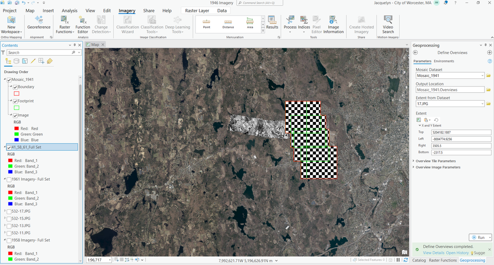

JackieMauro
Mosaic issue.pngWhen I use the mosaic tool, add the rasters, and then try to define the overviews, I am getting this checkered pattern instead of the pixelated imagery like shown to the left of the mosaic.

I have been messing around with it all day and still have had no luck. I'm wondering if this problem stems from the fact that the whole map document is saved onto a shared drive but the raster files, I have been georeferenced were initially saved and imported directly from my desktop? My desktop files automatically load into the shared drive, but I think they are still in different locations. This may be an obvious answer to you, but I am not used to dealing with Arc stuff that is this data heavy/deals with different pathways.

Those help a ton. I think the issue could be either OneDrive or the "special" characters in the path name. Try this...
  1. Move the source jpgs to a local folder (maybe make c:\myGISData or something like that)
  2. make a new file GDB at directory too.
  3. Then go through the whole workflow again, making the mosaic dataset in the new GDB
  4. and then create the overviews.
Sometimes OneDrive will only store files in the cloud and other times they are local on your computer, and it can be hard to figure out exactly where things are. By doing this you know that everything is on your computer and ArcGIS Pro should be able to get to everything it needs.
