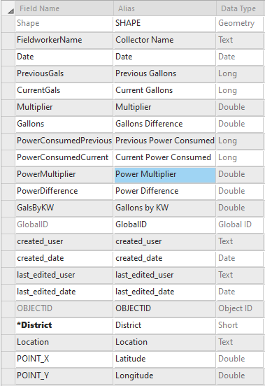

I have a point feature class in my local SQL Server Geodatabase like so:
I want to store points based on each district and location (district being the area and location being the point in the area) and in that point I want my fieldworker to be able to add data daily using field maps (so I suppose a new record each day).
