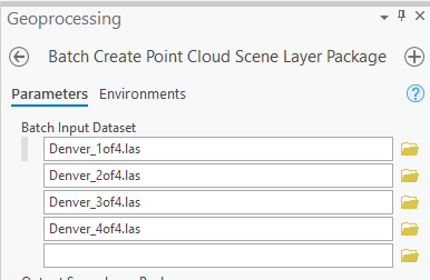

Thanks for testing on another subset. I think that narrows it down more to an issue with the LAS file JSON geometry. Without being able to review the LAS file myself unfortunately I'm not sure what else I can recommend. You may want to try and run the Convert LAS tool with all the LAS options enabled to see if that resolves the issue. Another option is you can right click on the GP tool and select Batch and then batch input to the tool and run it that way.
ValerieMFoley
Would it be possible to schedule a screen share technical appointment? The batch convert option is also not reading the files correctly.
