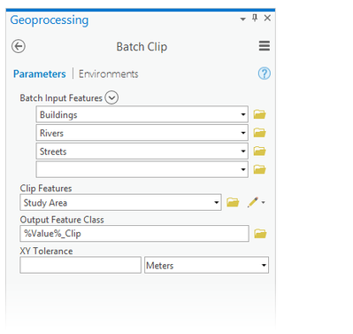

The Pro help doc (https://pro.arcgis.com/en/pro-app/latest/help/analysis/geoprocessing/basics/batch-geoprocessing.htm) is what I want to do (one AOI, several FCs of interest):

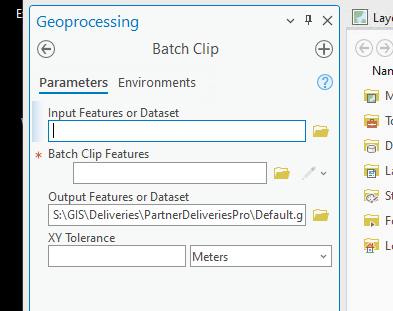

The Pro geoprocessing tool in my Project does the opposite:
Using the current Pro 3.1.3. I'm at a loss.

I don't see that happening when I select Batch on the Clip tool (also on 3.1.3)

TychoGranville
Doh. Didn't realize the tool is tied to the active map view as opposed to just dragging from the catalog or typing in the path. Makes it a little harder to jump around in a project.

You can add in datasets not in the view by dragging them from the catalog or clicking the Browse icon
