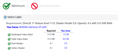

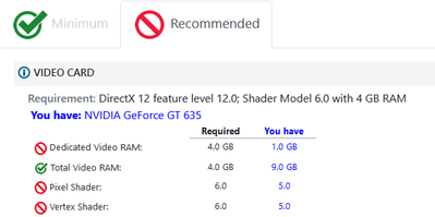

I am retired and use a personal use license on a Dell XPS desktop built in 2014 that has an NVIDIA GeForce GT 635 video card that meets the minimum spec but is well below the recommended specs but still meets my simple needs. I am warned that my PC won’t run Windows 11 without upgrading and a replacement is on the horizon.
Some random thoughts but inevitably it depends and more is usually better.
  • What you need depends on what you do or are likely to do. For example, working efficiently in 3D seems to require more video horsepower than working in 2D.
  • Meeting the recommended specs should keep you going for the next few years and may cost less in the long run due to the never-ending Windows and esri upgrades assuming you need to keep current. My PC had two empty memory strips that I used to boost my RAM to meet specs. If no empties, then I probably would have had to replace the existing RAM strips at greater cost.
