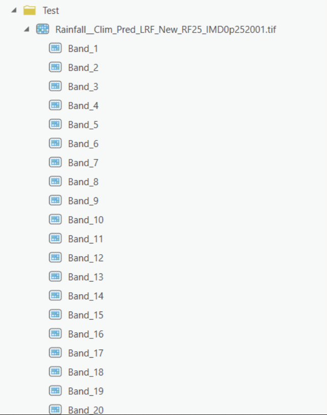

I have multiple NetCDF files which were converted into tiff files using the tools Make NetCDF Raster Layer & Copy Raster tool in ArcGIS Pro 2.6. As output, I now have multiple tiff files in a folder with many bands inside the tiff files. Here is a screenshot for reference.
As I have multiple tiff files of such kind, I am now trying to come up with a python script that can composite only certain bands.
So if the total number of bands in a tiff file is 365 I only want to composite Band_167 to Band_193.

wizgis
Hi @DanPatterson
Thank you for suggesting to use the list raster's method, it worked and I was also able to format output file name.
