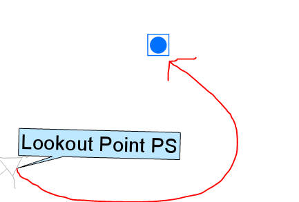

I am trying to move the location of annotation features and also move the vertex of  the balloon callout to the correct place.
It was easy in ArcGIS Desktop, but how do I do this now? very frustrating to say the least.
These features were created using Convert Labels to Annotation.

On the Modify Features pane (Edit tab>Modify or from the Edit tab tools gallery) there are three tools to edit annotation.
1.  Move.  Move supports 1+ selected annotation feature or a mixed selection
2.  Annotation.  Annotation tool supports moving, rotating, scaling, and onscreen text editing of a single annotation feature.  Also, context menu items for stacking, converting to multiparts, etc
3.  Edit Vertices.  Baseline vertex editing of a single annotation feature.
Please let me know if these tools do not meet your requirements.
