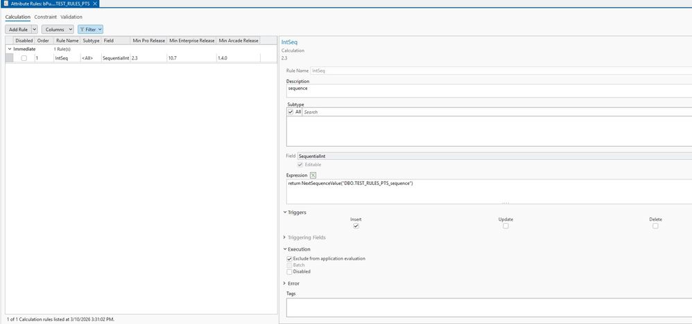

Just for completeness sake, I've included a screenshot of our attribute rule as configured for a DBO schema, where our expression is simply:
return NextSequenceValue("DBO.TEST_RULES_PTS_sequence")
