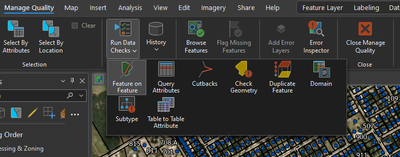

I'm wanting to write a script where I can automatically run the feature on feature data reviewer tool. It's not in the toolbox, only available through the Data Reviewer tab on Pro.
This is to help QC our water and wastewater data. So making sure all the water mains have point features where the lines break, everything is snapped properly.
