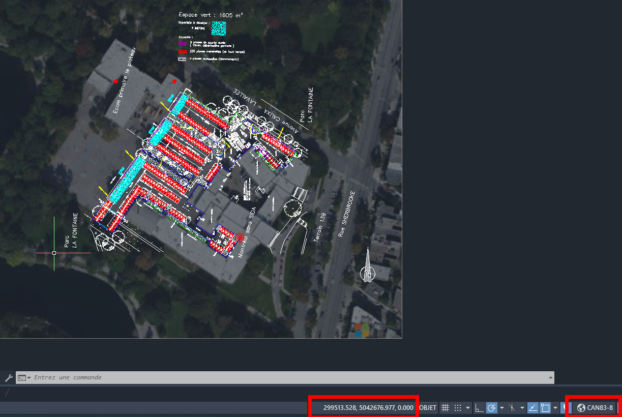

Here you can see that in AutoCAD, the model is placed with the right coordinates (bottom center) and it has the correct coordinate system (bottom right):

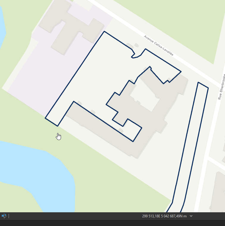

When I import the .dwg file in ArcGIS Pro, this is where it should appear (note the similar coordinates on the bottom, the polygon layer is a different source):

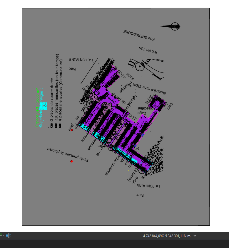

but it appears nowhere (and pivoted at 90 degrees and note the crazy coordinates):

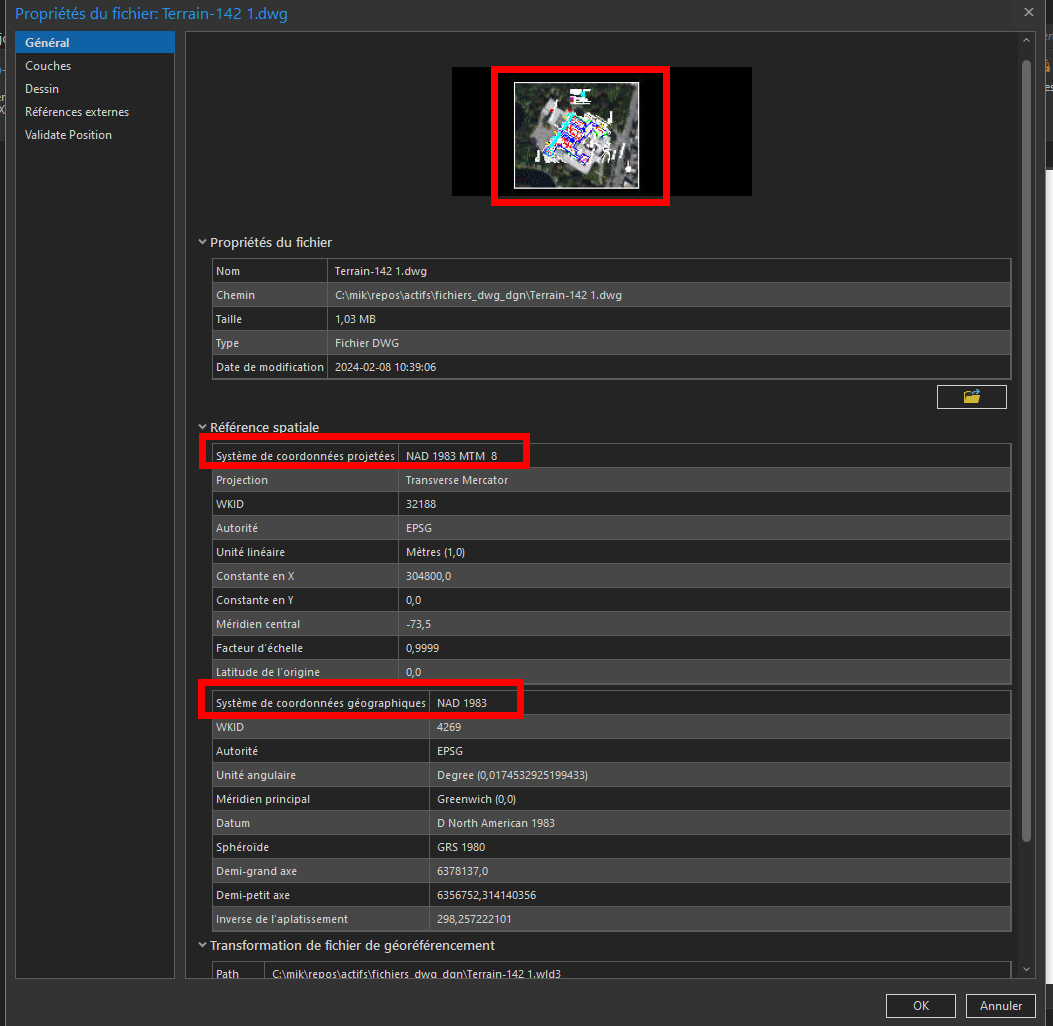

When I go in to the catalog tab on the left, right click on the dwg file and go to properties:
the thumbnail orientation is ok and then (sorry it's in french) under spatial reference I have projected coordinate system (32188) AND geographical coordinate system (4269). Could this be the problem? How to change the geographic coordinate system to 4326 ?!
