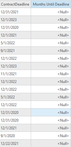

I have a shapefile of about 175 points that correspond to projects. Each project has a "contract deadline" field and a "months until deadline" field (see attached screenshot).
I want the "months until deadline" field to automatically update over time based off the date.
For example, a deadline of 12/31/2021 would have 4 "months until deadline" as of August 31. Instead of having to manually updated this every month, I'd like Arc to update automatically based on the current day of the year.

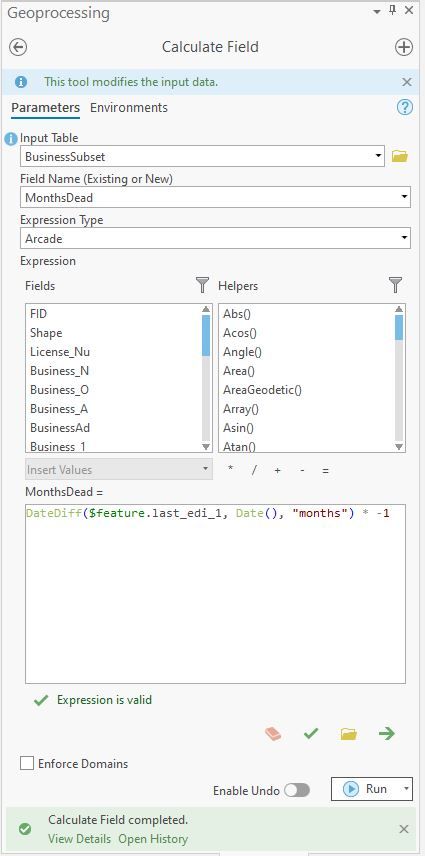

One way that I think you could automate this is create a Model in Modelbuilder that does the GP work on the shapefile. Then export it out as a Python script and associate the Python script with Windows Task Scheduler so it runs every day.  For example the Arcade expression I used in the screen grab does the month calculation for the difference between Contract Deadline and Months Until Deadline.

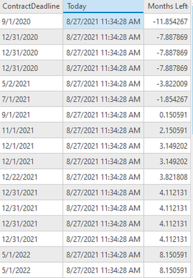

Thanks for the reply. I think i sort of got it to work..?
 I could calculate TimeDiff between Todays date and the "Contract Deadline", but now the goal is for that "Today" field to update essentially everyday or week. It wouldn't be horribly annoying to recaculate manually once in awhile but would prefer it auto calculates.
