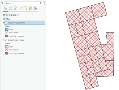

Workaround-1 (Preferred):
Define a non-solid symbology for HBP as well (see screenshot below).

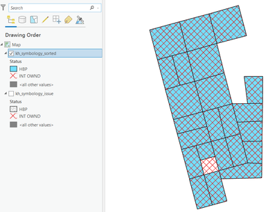

If you want to keep the HBP symbology as solid color, then you need to sort the layer based on the Status field in ascending order.
This will put the INT OWND values on top. So, you will be able to see both the values.

Since HBP has to be a solid color, I tested workaround-2.  I found that changing the order of the records in the shapefile does NOT negatively effect my other work with the shapefile. So going with the 2nd fix! Thank you again for your help.

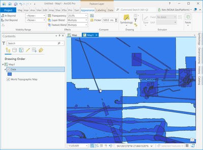

If you have to use solid colors, you could also look at the layer blending capabilities: https://pro.arcgis.com/en/pro-app/latest/help/mapping/layer-properties/apply-visual-effects.htm
We have a layer that has many overlapping features and by using the "Multiply" darkening mode, we can still see all the individual features.

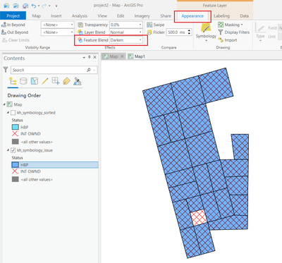

Feature Blend option (choose any darkening mode) under Appearance> Effects, should do the trick.
