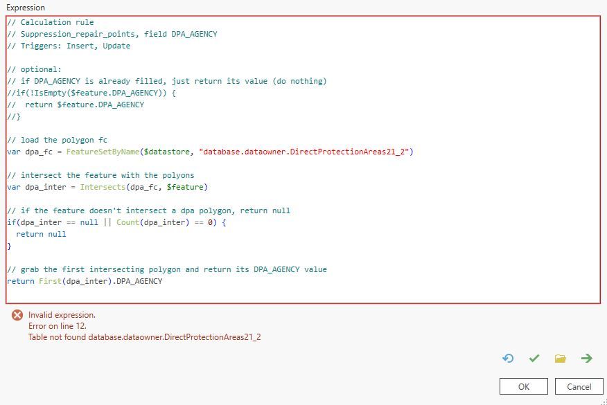

So I'd replace: "database.dataowner.DirectProtectionAreas21_2"
with: "DatabaseName.DataownerName.DirectProtectionAreas21_2"
JohannesLindner
MVP Alum
var dpa_fc = FeatureSetByName($datastore, "DirectProtectionAreas21_2")
Have a great day!
Johannes
BDU_RyanChittenden
What is dpa_inter and dpa_fc?
BDU_RyanChittenden
expression valid this time but:  ERROR 002717: Invalid Arcade expression, Arcade error: Table not found DirectProtectionAreas21_2, Script line: 12 [DirectProtectionAreas21_2]
Failed to execute (AddAttributeRule).

BDU_RyanChittenden
ERROR: INVALID EXPRESSION  ERROR ON LINE 12  Table not found DirectProtectionAreas21_2
