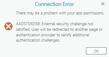

Our Azure tenant is deployed in Azure Government.
Followed these steps: Connect to authentication providers from ArcGIS Pro—ArcGIS Pro | Documentation
When I attempt to sign into the connection in Pro, I get this error:
I assigned demo_user permission to access the ArcGIS Pro Azure Enterprise app.
I also edited our conditional access policies to exclude demo_user from any policies requiring MFA.
Even with MFA, I complete the MS Authenticator prompt and still see this error in Pro.
The Azure enterprise app sign-in log shows successful login attempts with both MFA/not, no issues.
Anyone have any ideas?

We can close this thread, the problem was a CA policy in InTune scoped to demo_user requiring "All users terms of use". This is odd because demo_user has already accepted our all users Terms of Use policy. So, it seems like the ESRI auth. connection doesnt' support that CA grant control.
After excluding demo_user from that CA policy, everything works as expected both with/without MFA.
