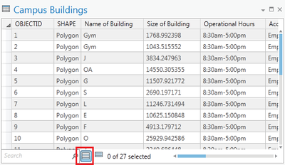

Please ensure, At the bottom of the table view "Show all Records" button is selected, NOT "Show Selected Records".
