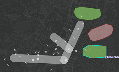

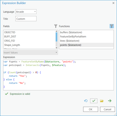

Not sure what is going wrong. I just did a test changing the attribute of the polygons depending if there are points inside the polygon and it all works as expected.

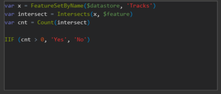

Arcade expression:

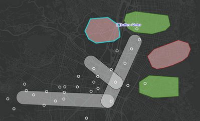

Capturing a new polygon with a point inside:
... automatically gets codes with "Yes" (green):

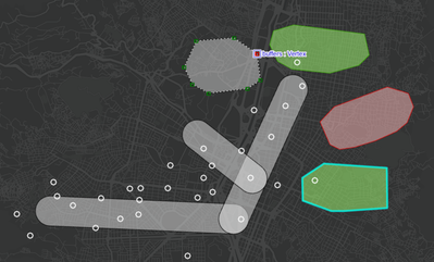

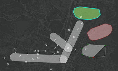

and when creating a polygon that has no point inside:
will automatically get the code "No" (red):

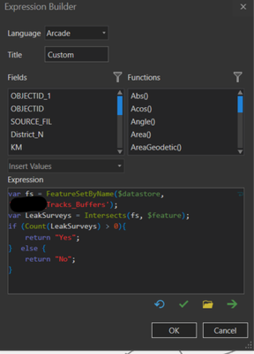

This is a screen shot of the tracks that intersect the buffer.
Here is the code, I used the same script from the field calculator and I thought that it would apply the same as an attribute rule.
Thanks Donovan

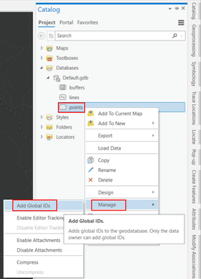

The first thing to look at would be making sure that your layer has GlobalID's. This is required for an attribute rule to work.

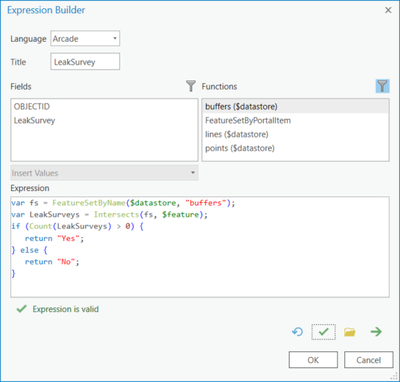

I did a test with some slightly different code and it seems to work:
var fs = FeatureSetByName($datastore, "buffers");
var LeakSurveys = Intersects(fs, $feature);
if (Count(LeakSurveys) > 0) {
   return "Yes";
} else {
   return "No";
The expression:

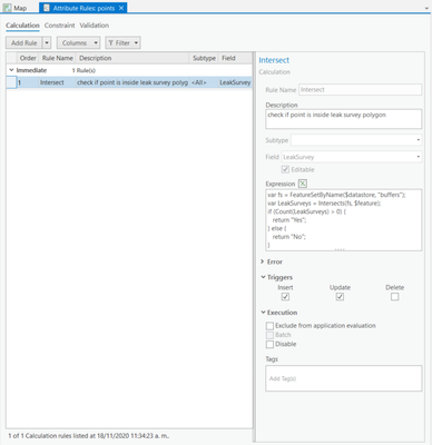

Attribute rule configuration:

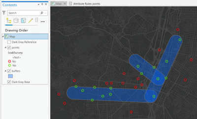

The result symbolized by LeakSurvey (Yes/No):
Remember to check your GlobalID's:

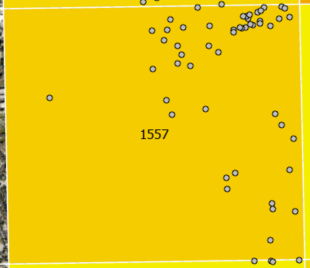

For example, the squared polygons below use an attribute rule to sum the employees of intersecting points. When the rule runs on polygons, it calculates 1,557. However, if a point if updated with +100 employees, the rule on polygons is not runned (not triggered)! The attribute stays 1,557 but it should now shows 1,657.
I have exactly the same Arcade script in use for PopUps and it does updates to 1,657 because the Arcade code is executed each time you open the PopUps.
