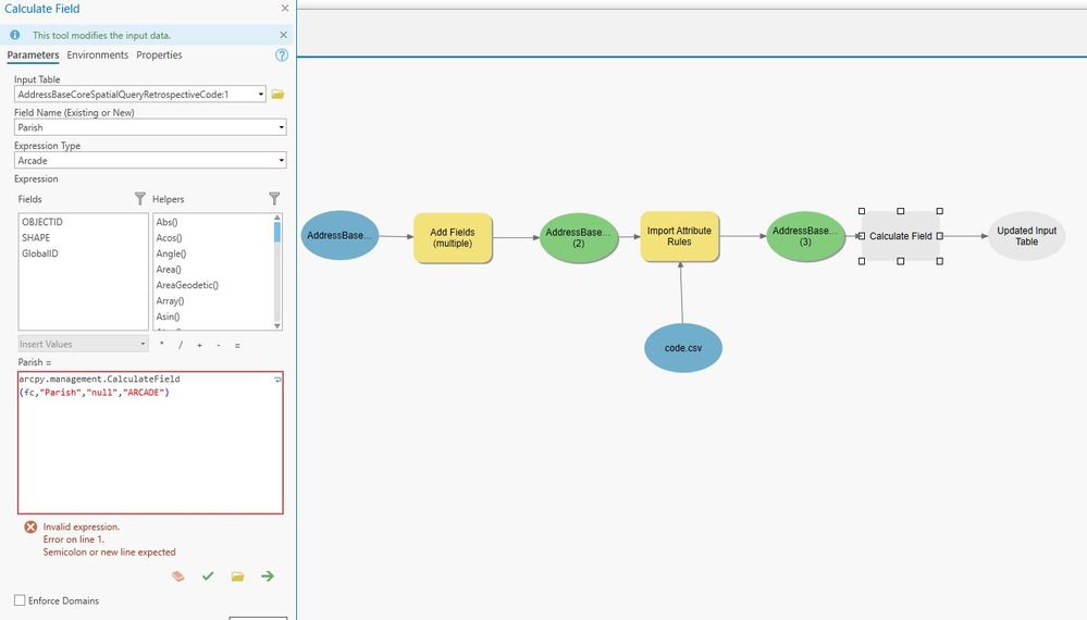

I've used Model Builder to add the 4 fields successfully & to import the attribute rule to the point FC.
The next hurdle is the code you use below to trigger the updates. It works in python but what do I need to enter into the 'Parish= ' calculation box?
arcpy.management.CalculateField(fc, "Ward", "null", "ARCADE")
JohannesLindner
MVP Alum
Literally anything. You just want to trigger the Attribute Rule, and the rule will calculate a new value for the Parish field.
//Parish =
"abc"
Have a great day!
Johannes

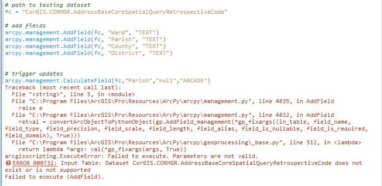

I've tried using the code earlier to create the 4 fields however I'm getting the below error
JohannesLindner
MVP Alum
You forgot the path to the database.
fc = "path:/to/your/database.sde/CorGIS.CORMGR.Blablabla"
Have a great day!
Johannes

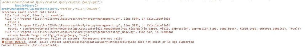

I've created a new table & the model imports the attribute rule that was exported from the old table but get an error now saying that it can't execute the calculation as that old table doesn't exist anymore however it's not referenced anywhere in the python code or model?
Do I need to create an attribute rule in this new table for it to work?
JohannesLindner
MVP Alum
That's the same error as in your previous reply. Did you actually change the fc path to include the databas?
Have a great day!
Johannes
