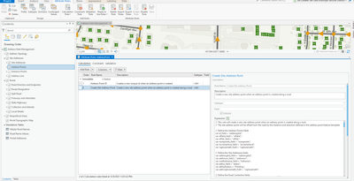

Take a look at the ESRI Address Data Management Solution; it has similar rules written between address points and related site address points. There is an aprx you can download that has sample data and the rules are applied there.
That should just about do it....

JoeBorgione
MVP Emeritus
The rules are fairly complicated, but I can find them by Right Clicking on Address Points in the table of contents, selecting Design and then Attribute Rules.  In the solution, the work flow has the user drop an Address Point on a street centerline and through a relationship class a Site Address Point is created.
