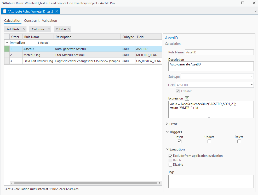

I have a lot of feature classes that automatically calculate an ID upon an 'insert' operation. This uses a MS SQL Server database sequence, which was also set up through ArcGIS Pro. This attribute works as intended for my purposes.
However, today I noticed that when I use Export Features to copy ANY (1 or more) of these features to a new feature class location, such as a file geodatabase, the attribute rule of the copied layer runs on the FIRST feature only, as if it was performing an 'insert' operation, but does not perform the rule on any other feature.

P.P.S This also happens on copies of copies of copies of the data, each of which inherits the attribute rule. It's not just when being copied from the SDE source. It also happens when the source is in a File Geodatabase as well. I will try to do some tests with another attribute rule that doesn't rely on a database sequence to see if it performs an 'insert' operation on the first feature no matter what the specific Attribute Rule content is.
