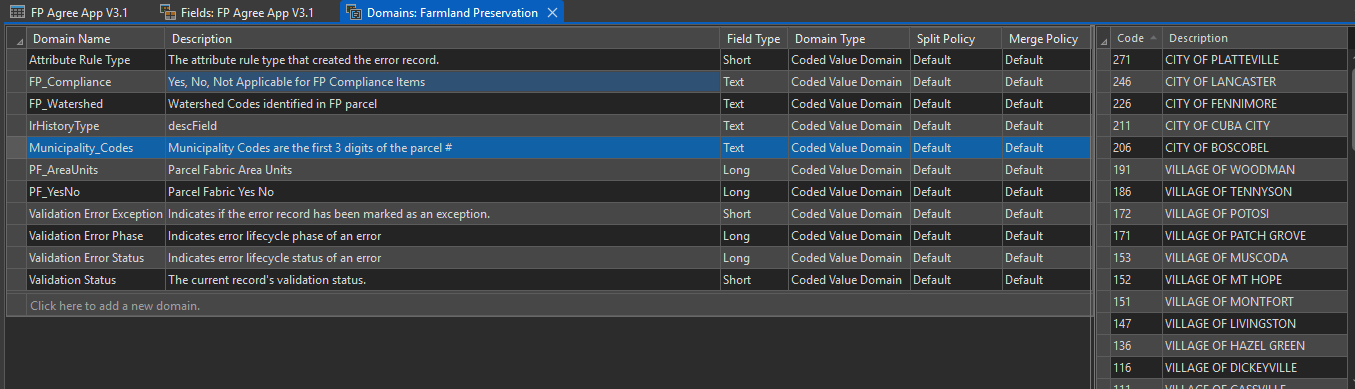

My goal with this rule is to get it to auto-populate our municipality field with a domain description when a user types in a parcel number.

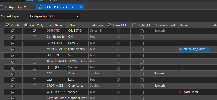

I have assigned the Municipality_Codes domain to the Municipality field.
Here is what the Municipality_Codes domain looks like:
The first three numbers of the Parcel # coincides with the three numbers assigned to each municipality in the domain.
