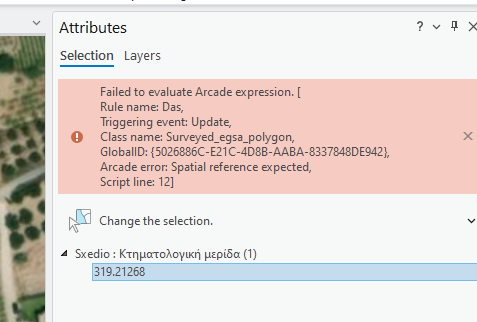

KosThe
Thank you so much for your reply @GlenterpriceUK, I did update the attribute rule per your instructions, but it does not recognize the "Project" funtion. The Spatial reference is accepted, but when I add the project function I get the message bellow
