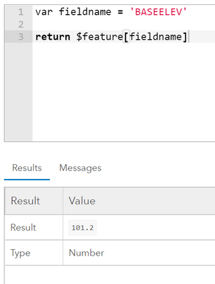

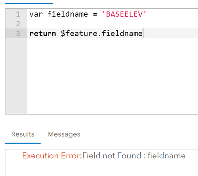

A few different things.
1. In a for loop with an array, your variable is the index. Use parentarray[index] to access the actual contents of that item.
2. You're adding the text string "$feature." to your fieldname variable, which you are then accessing with $feature.fieldname. Written out, that would be "$feature.$feature.", plus whatever your field name is.
Accessing fields with dot notation only works with literal field names, and then only if the field name has no invalid characters.
Instead, try using bracket notation. Your field name in this situation is just a string, so you can pipe in any variable.
3. Establish your count outside of the loop. Otherwise you're going to re-set it to 0 every time it goes to the next field in the list.
There are lots of ways to do the counting bit, but looking at the fields in a for loop seems fine. You probably don't need so many variables, though.

jcarlson
MVP Alum
