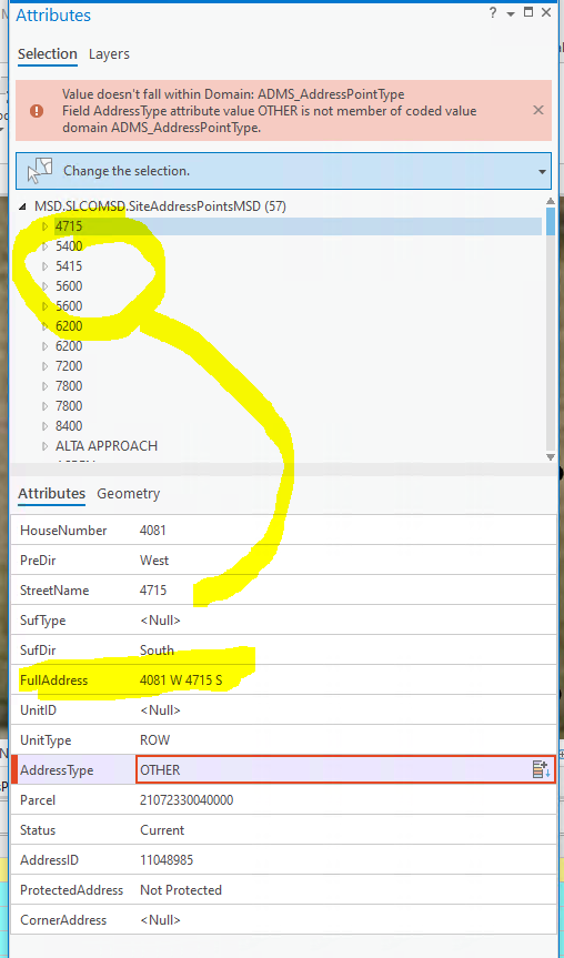

Is there a way to change the look and feel of the the Attributes Pane?  In the example below,  I have a number of site address points selected, and they are titled with the street name field.  I'd like to change that field to the full address field, but I don't see how to do it.  I thought maybe the pop up properties would do it, but that's not it.

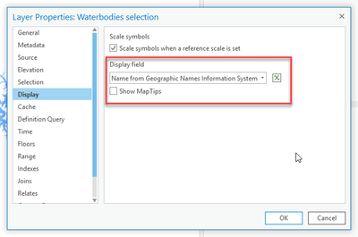

Hi @JoeBorgione Set the "Display field" in the layer properties to the field you want. You can also create an expression.
Does that help?
