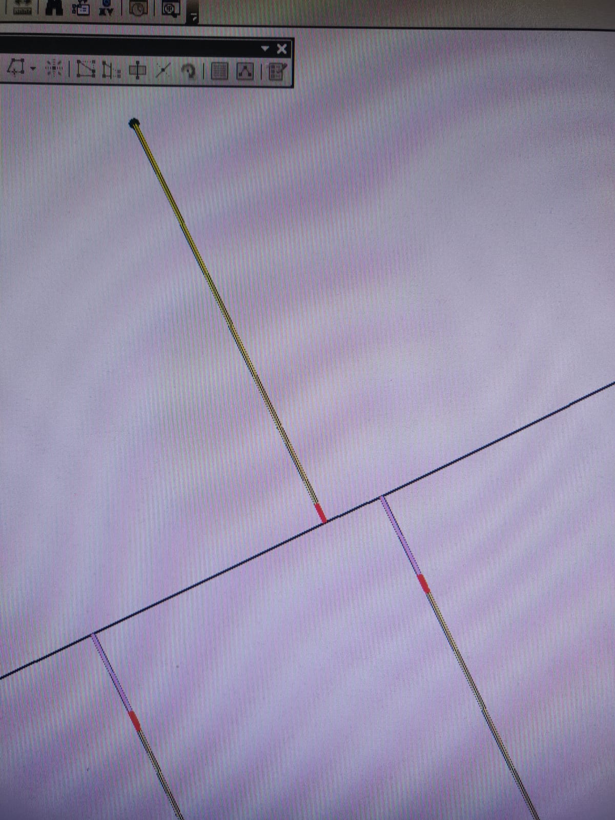

Good Morning,
I have a problem regarding ArcMap/ArcGISPro.
As you can see on the screenshot. I have several polylines and one point at the end. I wanna build a Model that answers the question if the point is directly connected to the black line or has to pass the pink line before. If it goes directly the point feature shall get one into the attribute table. If it has to pass the pink one first it shall get a zero. I would be very happy for any help since my ArcGIS knowledge is limited.
Kind regards, Fynn

The "Near" tool will return a distance of 0 if the point is connected to a line and a distance otherwise.
Near (Analysis)—ArcGIS Pro | Documentation
"Spatial Join" within a distance, criterion will do a similar thing
Spatial Join (Analysis)—ArcGIS Pro | Documentation
Have a look at those, since there are variants if they don't get part of the question answered
