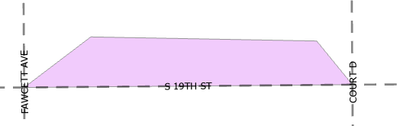

I'm trying to convert from using Attribute Assistant to Attribute Rules and I'm struggling with one of my old rules built with the INTERSECTING_FEATURE method.  Here's the problem:
I'm mapping parking blocks and I need to pick up the street name of the longest intersecting street segment (S 19th St in the simple illustration below)
The ArcMap/AA method worked beautifully and seemed to pick up the longest edge most of the time.  However with the new Attribute Rule that I set up (using Pro 3.0), it seems to pick up the other streets that it intersects with, even if it's just one vertex (COURT D or FAWCETT AVE above).  When I loop through all the features it seems random, so I can't use the FIRST function.
I think I'm still not understanding the fundamentals about how the Intersects function works.  Does anyone have any suggestions on how to filter out the street segment with the longest intersecting edge?
Thank for you thoughts and suggestions!

Intersects() finds all intersecting features. In the next step, you have to get the actual Intersection() and find the longest one.
// find intersecting streets
var streetLayer = FeaturesetByName($datastore, "baseStreetCenterline", ["ST_NAME"], true)
var streetIntersect = Intersects(streetLayer, $feature);
// find the street with the longest intersection
var name = null
var max_length = -1
for (var street in streetIntersect) {
    // get the intersection
    var segment = Intersection($feature, street)
    // get the intersection's length
    // if the line and polygon only touch at one vertex, segment will be null
    var segment_length = IIF(segment == null, 0, Length(segment))
    // compare to max_length, set name
    if(segment_length > max_length) {
        max_length = segment_length
        name = street.ST_NAME
return name

tSteve_SchunzelAtTacoma
You're a genius Johannes!!  That works perfectly, thank you!!
