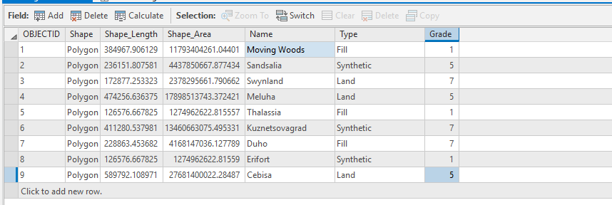

I have some fake data that includes 3 non-Pro generated fields:
  1. Name: Unique to each record
  2. Type: Repeats
  3. Grade: Repeats

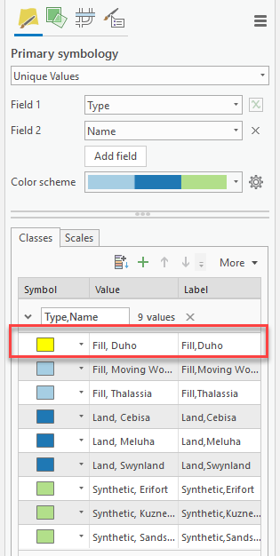

In my symbology pane, I can symbolize using a repeating value, and combine it with a unique value. This will allow me to select a particular record and set it to a unique color:
I set the yellow color by double clicking the color swatch next to 'Fill, Duho' and selecting yellow.
All of my 'Type' categories are still there (Fill, Land, and Synthetic) but they've been combined with my 'Name' values to create unique values that I can then manually symbolize. The result looks like this:

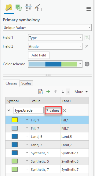

This will not work, however, if I combine my two repeating columns, and the polygon I want to symbolize no longer has a unique value.

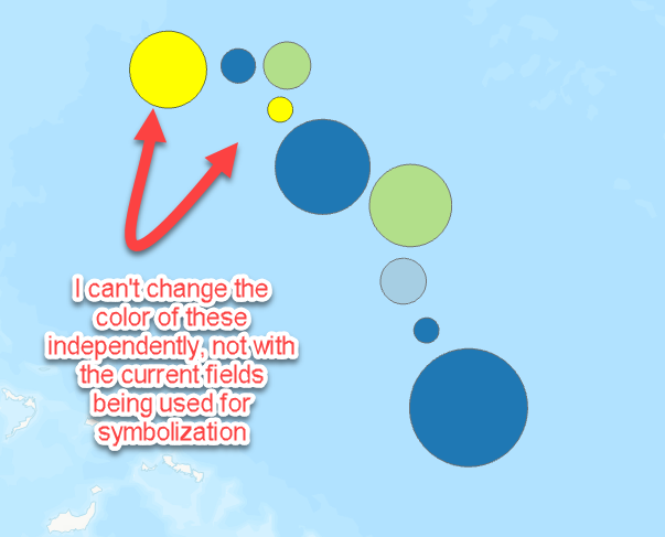

There are only 7 values out of 9 total records, meaning that two polygons are being symbolized by the same value. We can see this if we change the top option to yellow:
