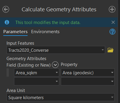

I would suggest you to calculate Geodesic Area, since it considers Earth's curvature and gives you more accurate area.
Calculate Geometry Attributes (Data Management)—ArcGIS Pro | Documentation
or using Calculate Field like
!shape.geodesicArea@squarekilometers!

Thank you very much for your reply. Yes, I have used this tool to calculate Geodesic Area, so I suppose it is correct.
In the "calculate geometry attibutes", in coordinate system I used the WGS_1984_Web_Mercator_Auxiliary_Sphere and Robinson projection for all my calculations in all continents. My question is, if due to distortions, these calculations are not reliable and I have to use each continent projection for area measurements. Or if it is irrelevant and using the same coordinate & projection system for all continents is correct.
