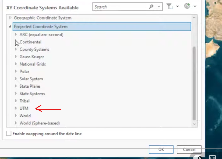

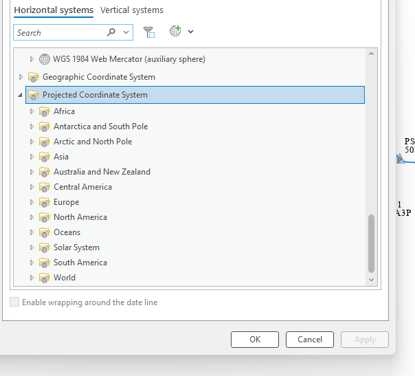

SimSareythun168
i saw arcgis pro of my friend have UTM folder in projcted coordinate Systems but for my Arcgis pro don't have it what's can i do.1.png2.png
