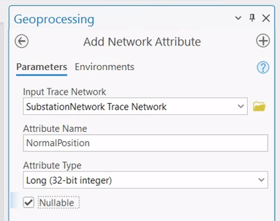

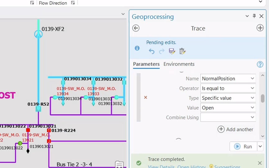

I’m seeing unexpected behavior after I add a new “Network Attribute” to a Trace network.   Here are my steps.
1.       Disable Trace Network Topology

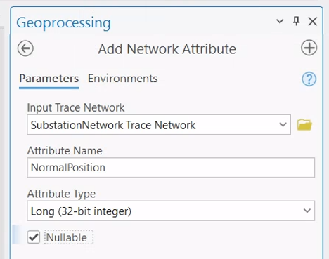

2.       Add a new Network Attribute named “NormalPosition” of data type Long

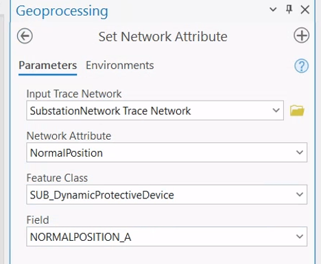

3.       Use Set Network Attribute to assign this network attribute to a (Long) field named NORMALPOSITION_A
4.       Enable Trace Network Topology

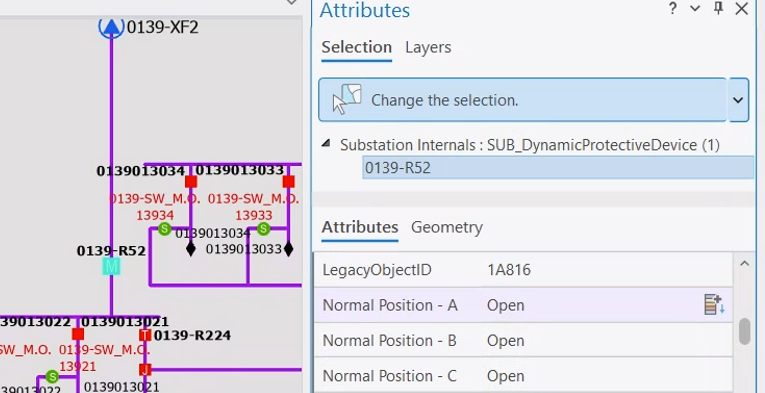

5.       Change the value of NORMALPOSITION_A on a feature from “Closed (1)” to “Open (0)”.  Save edits and validate topology.

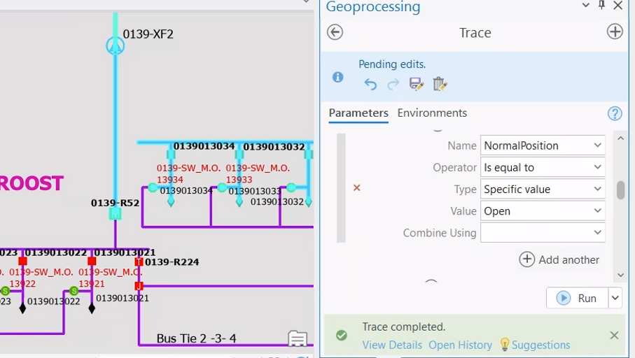

6.       Perform a trace with a barrier defined to stop at NormalPosition = “Open”.  The trace stops at the newly opened device, as expected.  All good.

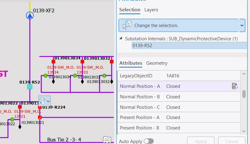

7.       Change the value of NORMALPOSITION_A on the same feature back to “Closed.” Save edits and validate topology.
8.       Perform a trace with the same barrier condition and it STILL STOPS at the device which was changed to “Closed”
Any suggestions on what I might be missing would be much appreciated.

That said, I've followed your steps exactly -- to the point of making sure there are *no* dirty areas in the database after completing my edit and validating and saving.   I still get the same result.   If I change the normal position of a device from open to closed, then perform a trace which has a barrier condition of normal position being "open", then the trace still at the newly closed device.
FWIW - I've also made sure that the domain codes are as expected; Closed = 1; Open = 0.
Ed
