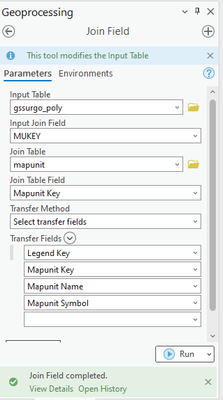

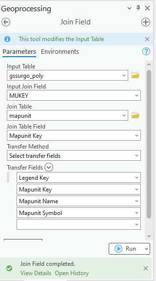

When I run this: arcpy.management.JoinField("gssurgo_poly","MUKEY","M:/public/fw3540_labs/2022/lab7/gSSURGO_MI.gdb/mapunit","Mapunit key",["Legend Key","Mapunit Key","Mapunit Name","Mapunit Symbol"])
I get the dreaded 9's, and nothing changes in my table.
When I run this (note I have changed from Alias to Field Name): arcpy.management.JoinField("gssurgo_poly","MUKEY","M:/public/fw3540_labs/2022/lab7/gSSURGO_MI.gdb/Mapunit","Mapunit key",["mukey","lkey","musym","muname"])
I get the dreaded 9's, but the four fields populate as Null values.
When I run this: arcpy.management.AddJoin("gssurgo_poly","MUKEY","M:/public/fw3540_labs/2022/lab7/gSSURGO_MI.gdb/Mapunit","Mapunit key")
All the fields populate as Null values
When I run it in the tool:
Runs like a dream.
Just a bug, or am I missing something obvious?

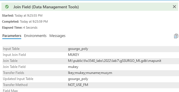

You're using an alias as join field ("Mapunit key"), that might be the problem. Try with the actual field name.
If you can run it from the tool, then go to the geoprocessing history, right-click on the successfull tool run, send the code to the Python Window, and analyze the command.

I'm not OP, but changing from field alias to the actual field name solved this issue for me
(ERROR 160637: The name of an entry in the CodedValueDomain is empty.)
