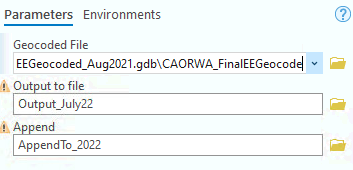

When I run the script multiple times, a yellow "!" appears letting me know that the FC exists.

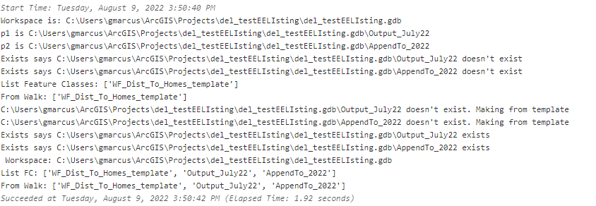

I'm using full paths in the dialog box, but I tested the script first with basenames, later with full paths and there's no difference.

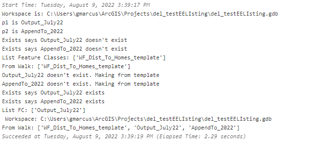

1) I print the workspace variable when the script first runs and see that it is the GDB that the files reside.
2) I run Exists next (it's false)
3) I run ListFeatureClasses, and the files I want aren't listed (even though they're in the catalog view)
4) I copy a template and store it in the names of param1 and param2
5) Exists finally sees it now, but not on the next run.
Files aren't there?!
I'm lead to believe that the workspace value isn't properly set?

But when I switch to full paths there's no difference. Walk is using the workspace variable.
The files still aren't being shown. What's happening?
