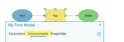

Good morning,
Is there a way to initialize this variable in Model Builder ArcGIS Pro?
arcpy.env.qualifiedFieldNames = False
We want to get only the fields names after a join, not all the fields prefixed with the Feature Class  or Table .
Thanks

Assuming you are adding a tool that creates a new dataset from the joined layer (e.g. Copy Features) to your model. You can uncheck the "Maintain fully qualified field names" environment setting in the tool element properties - Environment tab after you add it to the model.
