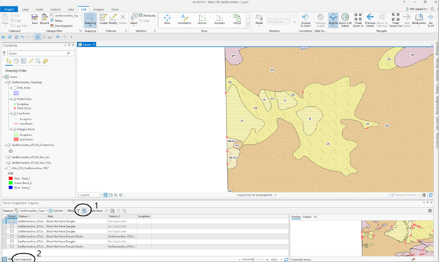

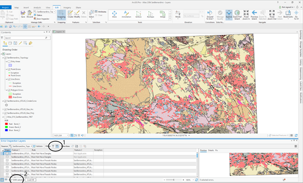

  1. Open Error Inspector
  2. Validate map on full extent
  3. 1) Filter by Map Extent is Active. 2) *2000 errors exist in the full map extent.
    1. Currently I am only worried about dangles along the quad border. I zoom into a location I want to inspect. 1) Filter by Map extent is active. 2) 6 Errors in map extent.

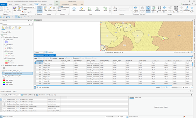

  4.  Open Attribute Table.

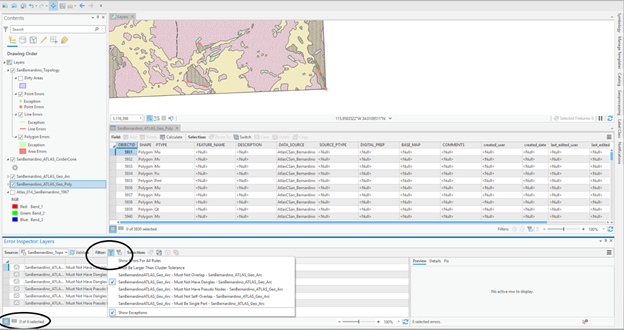

    1. Zoom to full Extent. 1) Filter by map extent still active 2) Only 6 errors are listed 3) even after refreshing the table.
    2. If I zoom to a new location the table still does not refresh and will not properly populate this table until I have restarted the map project. It will function after restarting the program until I open an attribute table. After that the table fails to refresh.

The image in step 7 shows the map extent filter is off. What steps lead to that being turned off?
RachelBeard
Hello Sean,
I turned the map extent filter off in the screen shot to show that even without the filter only 6 errors display when there should be 2000+.
A bit after posting this, I worked with ESRI Tech support on this for a couple weeks and it was reproducible on their end with their data. Unfortunately, it is a bug.
