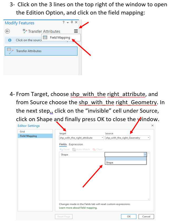

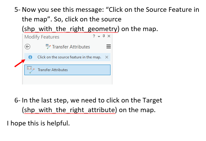

There is a python way to replace geometries but I don't know how to create a safe "press button" or copy/paste solution in ArcPro.

SepidehDadashi_DFFM_AZ
