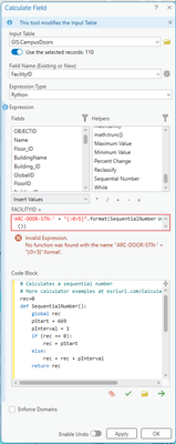

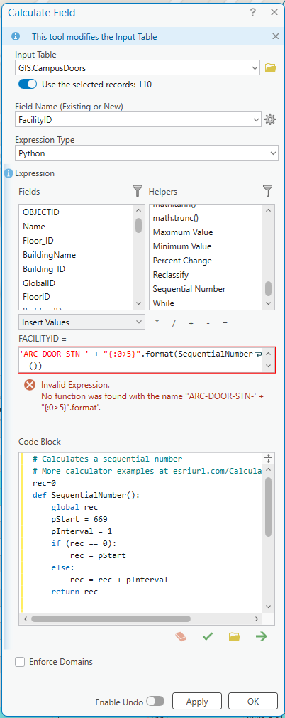

Hello,
I am trying to calculate a field with a constant text string and sequential numbering with leading zeros. I have used this expression and code block previously and been successful but now I am getting an error that it cannot find a function that matches the text string. Obviously, there would not be a function matching my text string, but I am not sure why it is not being recognized as a string with the ' '.
Any help would be appreciated. Thanks!
Expression: 'ARC-DOOR-STN-' + "{:0>5}".format(SequentialNumber())

StephanieO1
The expression is now valid but I am getting this error:
This seems like an easy fix but I am not sure where/how to change the int to string. Thank you for your help!
