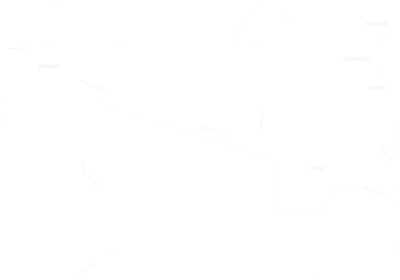

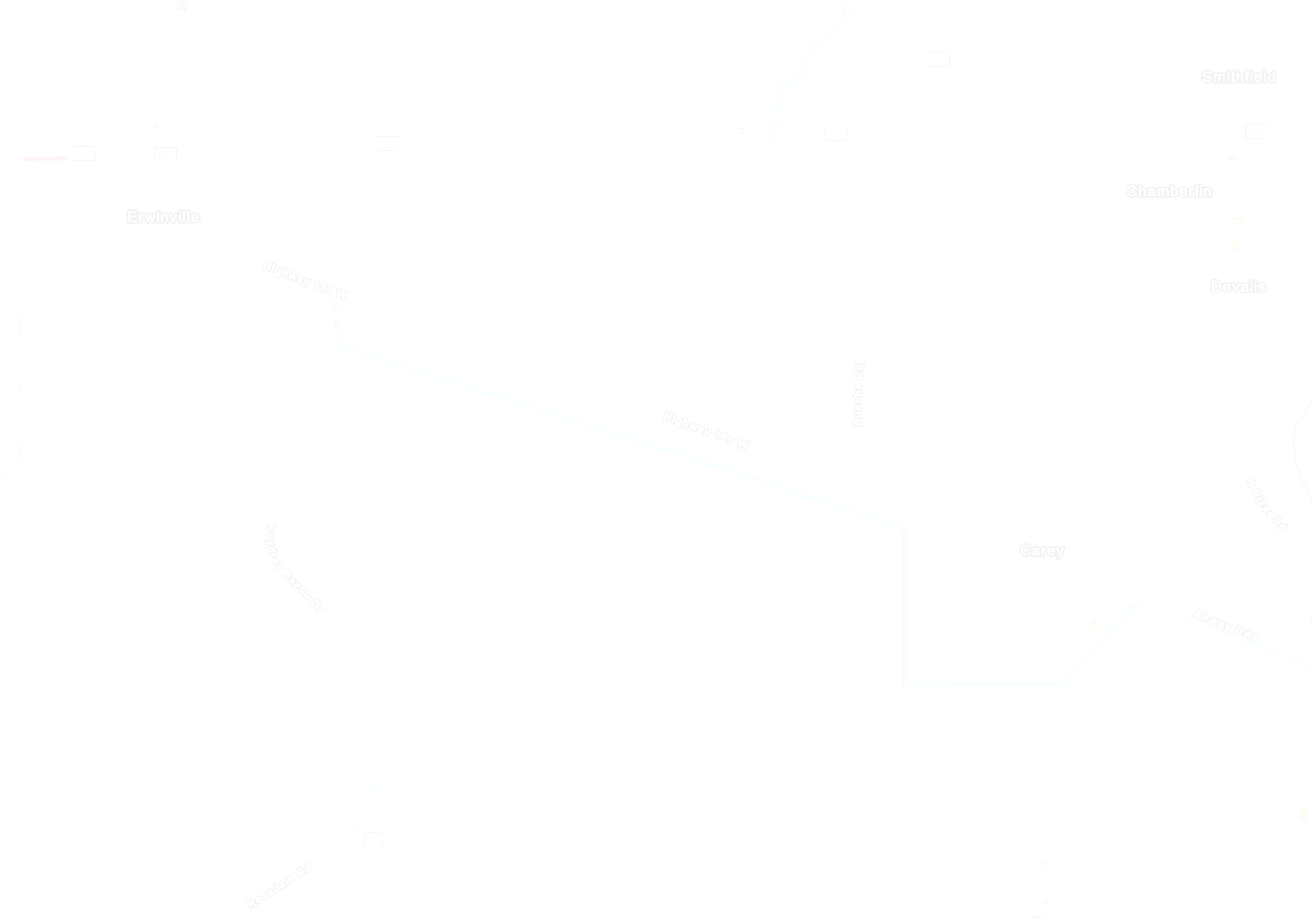

I have a Plugable usb 3.0 and usb-c dual displayport or hdmi display docking station. It worked fine with my 2 extra monitors, but since upgrading to arcpro 3.4, maps and layouts will not render in the connected monitors. They are 90% opaque. Everything else, including PDF exports of maps looks fine. Has anyone experienced this and ... resolved it? I am in communication with plugable as well and will relay what they say if it has something to do with ESRI software.

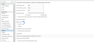

Thank you. I've updated the docking station firmware, and tried several different chords. plugable thought it could be the rendering engine setting. https://pro.arcgis.com/en/pro-app/latest/help/mapping/properties/display-options.htm#ESRI_SECTION1_C... I'll check when I get a chance. Thanks for your input.
RandyMcGregor_BMcD
Plugable researched it and discovered that 3.4 uses the DirectX 12 rendering engine and that setting might be the culprit. It was but not the way I expected. I checked and found that DirectX 11 was set and changing to the new setting fixed the problem:
