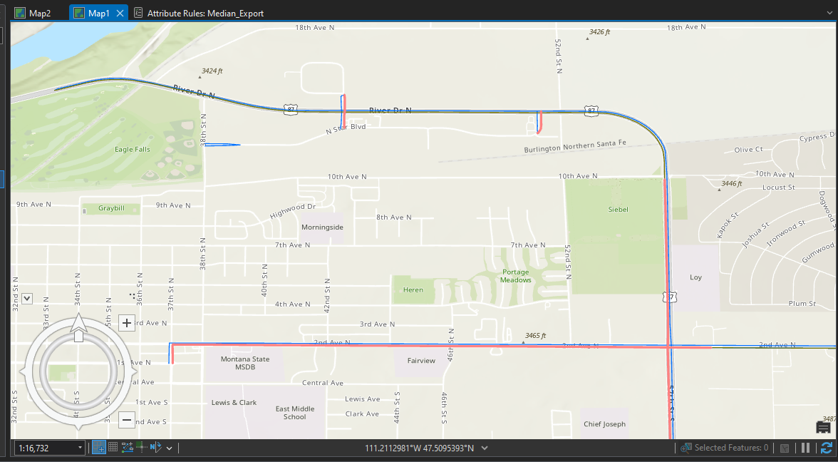

I'm working on a data check that will flag in red (validation attribute rule) any median that DOES NOT have a divided highway. I used the code above and added an extra condition to exclude evaluation for Two Way Left Turn medians. I'm getting weird behavior. It ignores TWLT as expected, but it still flags things that have a divided highway. Here is my code and a pic. In the pic, the 2 lonely lines at the top are correctly flagged because I removed their divided highways. The other two longer roads (that cross each other) have a divided hwy but still get flagged. I'm stumped on this one. I confirmed that the lines do overlap. Same ROUTE_ID, begin and end. They do have Z values if that matters.

check to make sure overlaps make since using an Arcade field calculation first.
